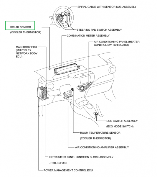

請問大大Solar Sensor (D Side)有抓到數字嗎?
這個好像是大P用來自動開啟頭燈的,PC好像沒有?
 楼主| 发表于 2013-12-19 14:03 | 显示全部楼层
本帖最後由 EddieTsai 於 2013-12-19 14:14 編輯
Solar D 的值是 Solar 傳感器偵測值
主要是用來補償冷氣強度...
Thesolar sensor detects (in the form of changes in the current
that flows thoughtthe built-in photo diode)the changes in the
amount of sunlight and outputs these sunlight strengthsignals
to the air conditioning amplifier assembly.

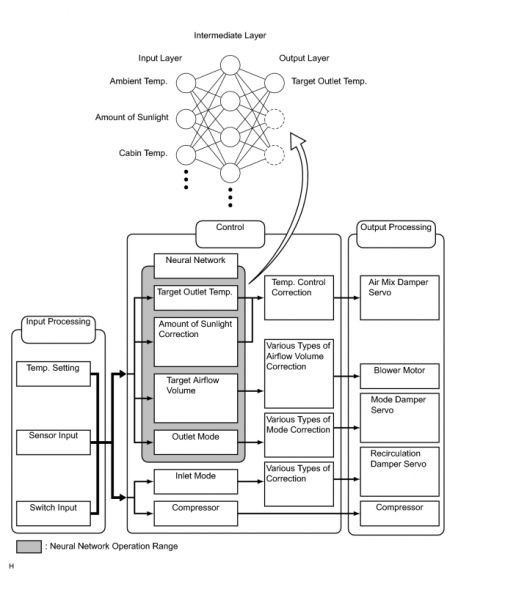

有沒看錯,類神經網路晶片耶!
